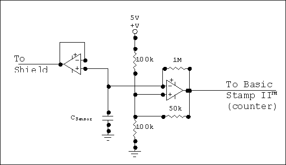

I make the sensor using 2 aluminium strip plates (one side is sticky) as sandwich in the middle a plastic strip. I tried 4mm, 5mm, 7mm, 0.5mm distances for dielectric size between 2 aluminium plates. Is there any problem?
I tried with 5cm height strips and 2.5cm height strips too... I tried 1.2 meters length and ~2.4 meters length...
Do I understand wrong? You said that I can't get good results using CapMeters? And I should use the oscillator method for best result? In other words, the capacitance changings cannot be detected by the capmeter, is this correct for you?
Also now I tested the strips' conductivity using my multimeter's short circuit test (beep) option, it beeps normally, that means the capacitor "sensor" is totally connected to the measurement circuit and the cables are OK. There are no any simple mistake. The problem is I can't get changings on more than 2 cm distance...
What to do?

I get this with 22pF real capacitor:
And this is result of 10nF real capacitor
My circuit counts 2131 when there is no any capacitor connected.
I use this formula for calculating the capacitor value:
Cap = (T-2131)/ClockFreq/Resistor_value
9.94nF = (439750-2131)/(20Mhz/4)/8.8Mohm <----- 10nF
15.9pF = (2833-2131)/(20Mhz/4)/8.8Mohm <----- 22pF
8.9nF = (396627-2131)/(20Mhz/4)/8.8Mohm <----- the sensor
