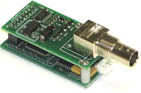

Buscando programas que implementen funciones e interpolaciones, he caido en esto:
http://jonw0224.tripod.com/ppmscope.html
Se lo ve prometedor al chiquitin. El soft es bastante completo y tiene interpolaciones splines y sinc
Viene con soft para PC, el firmware del pic (en assembler!) PCB, lista de componentes, etc.etc.
Me queda chico todavía:
Improvements to the protection circuitry on the analog front-end improve protection and the analog bandwidth. In October, a user pointed out that the oscilloscope was bandwidth limited. The bandwidth limit was around 1 MHz. However, you could see the bandwidth limitation readily with a lower frequency square wave when the square wave is sampled at 5 MHz time equivalent sampling mode. The changes are simple and can be implemented without re-etching boards, but by changing out four components. The changes raised the analog bandwidth of the scope to 5 MHz or higher.
La limitación del ancho de banda parece venir de la parte analógica :unsure:
Esperemos poder superar eso :D
Si, en realidad lo que mas me sorprendio es el software. El hard usa un conversor lento tambien (que bien podria reemplazarse por el conversor del pic para un portatil)
