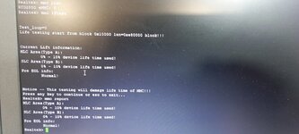

Current platfrom partition table format is not GPT!
it is necessary to replace the first 512 bytes in the lamp if there are such lines in the log :
[check_pmbr_LBA0][115]Current platfrom partition table format is not GPT!
[check_gpt_context][268]check pmbr LBA0 fail!
[init_global_gpt_partition_info][333]GPT context check fail!
[get_gpt_entry_by_name][407]parse gpt partition info fail!
mmc_read_and_flush: read sector aligned to partition bounds (1)
